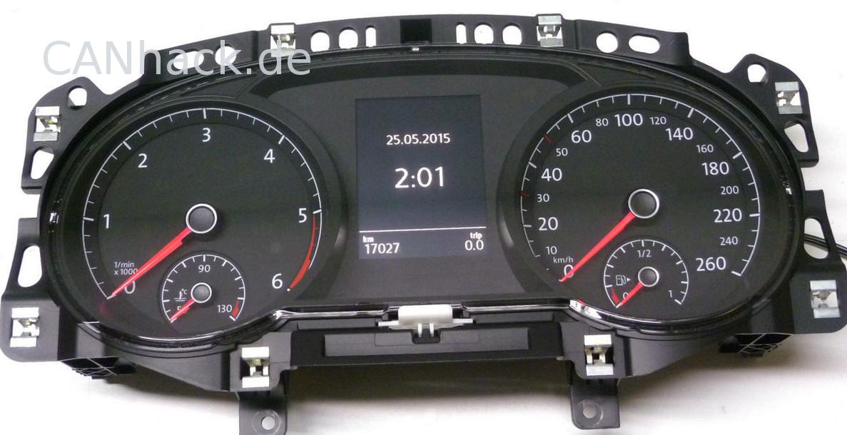

Hello everyone!
As I mentioned in my introduction, I'm relatively new to the world of bus-controlled devices, but I'm definitely not unfamiliar with technology. And a healthy dose of ambition is added to that.
Since I've only come across a single post about the CAN bus in the Golf 7, I hope you're still interested in the information about the instrument cluster (KI), or that you can help me with controlling it... even though I don't own a Golf 7 myself and therefore can't provide original recordings.
But from what I've read so far, things are quite similar across different VW models, which hopefully means that a lot can be solved through trial and error.
While I'm still learning about the basics, I would still like to ask a few general questions.
1) Should it be possible to start the AI system even with only one additional bus participant (AVR 8-bit microcontroller), using indicator lights and needles?
2) Can the MFL keys also be emulated? Or does it require an MFL control unit / a third bus participant?
3) Do you think that simply trying out known Telegram sequences for Golf 4, 5, and 6 models is sufficient? I don't have a CANUSB adapter here yet to potentially... To be able to read responses.
Greetings.
Amrius.

Post05-11-2014, 9:49    Subject: Golf 7 instrument cluster, gaming dashboard Quote
It would be worth a try. The speedometer from the Golf 7 is likely used in other vehicles as well, and it might be possible to access a CAN trace.
With RKS+CAN, it would be possible to directly control a dashboard using the telemetry API of PC games.
Therefore, racing games, truck simulations, and similar titles can be played with a "real" cockpit. Only the pedals and steering wheel are missing for a real driving simulator.
https://github.com/Funbit/ets2-telemetry-server
The code example for RKS+CAN can be modified to retrieve values from the racing game's telemetry API and then send corresponding CAN messages to control the instrument cluster.
Code example: http://www.canhack.de/en/viewtopic.php?t=137
 Kombiinstrument Golf 7 für Fahrsimulator
 File size:  172.01 KB
 Viewed:  10193 times
