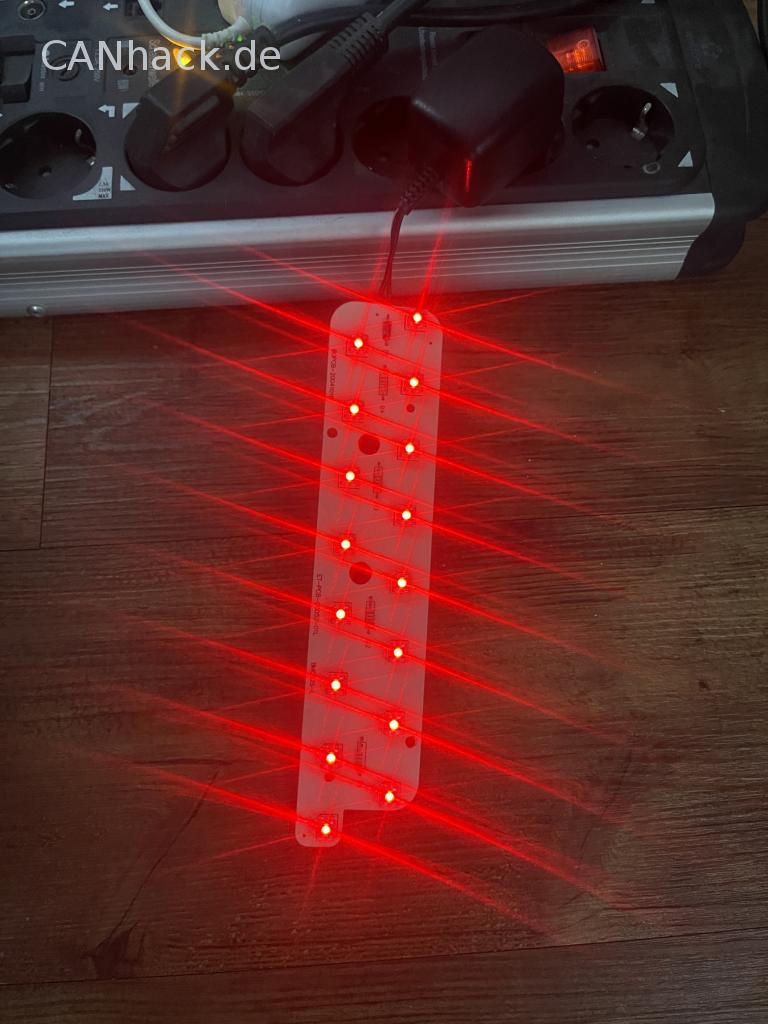

Check if there are any resistors (R1 - R4) on the long circuit board acting as current-limiting resistors before the LEDs. If so, you can try applying power with a 9V battery and see if it lights up. Test both polarities of the 9V battery, especially if the polarity is not indicated on the connector or circuit board.
With a 9V power supply, the LEDs should at least light up faintly; if they do, you know that the basic setup is working. Are the diodes okay?

Post23-04-2023, 11:09    Subject: LED taillights Quote
I tested it. I didn't have a 9-volt battery on hand, but I did have a transformer with 5 volts and 180mA.
It was enough to run it.

I figured out exactly what kind of LEDs they are.
SuperFlex VIS TLWR8600, RED.
The data:
2.2 volts.
70 mA.
So, I just added up the values of the four consecutive numbers.
0.07 A x 4 = 0.28 A
So, I calculate that 12 volts / 0.28 amps equals 3.36 watts.
Since two bulbs are running and both of their power is being channeled into the LED, I'm adding their wattage together.
5 watts x 2 = 10 watts.
Subsequently, I calculated.
10 Watts minus 3.36 equals 6.64 Watts that still need to be vaporized.
So, I'll continue calculating.
6.64 Watts / 12 Volts = 0.553 Amps.
Now, regarding the resistance:
Resistance R = 12 Volts / 0.552 Amps = 21.699 Ohms.
I have adjusted the resistance to 22 ohms.
I've picked them out.
https://www.reichelt.de/drahtwiderstand-axial-7-w-22-ohm-10--7w-axial-22-p110655.html?&trstct=pos_2&nbc=1
Here is my question.
Do I need just one resistor, or four resistors, since there are four LEDs in series, and another four LEDs connected in parallel to them?
I'm not quite sure I understand anymore.
The resistors I bought are 390 ohms, while the originally installed ones were 400 ohms.
Since I connected my four 390-ohm resistors in parallel, the value is divided by 4.
However, I also need to add something.
I supplied the circuit board where the LEDs are mounted with 12 volts using a transformer and measured the voltage after the resistors. The reading was 7.32 volts.
Before the first LED.
After the first LED: 5.48 volts / 3.64 volts / 1.82 volts.
And I have the same values for all four rows.
I'm not an expert in this area, and I'm trying to contribute as much as possible.
But I just can't seem to figure out this system...
