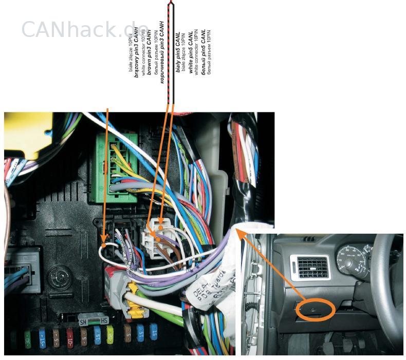

Ich möchte einen Arduino mit meines Peugeot 207 CAN-Bus verbinden. Es ist mich noch nicht gelungen, mit Kabeln im Radio oder der ODB2 Stecker.
Hat jemand mit einem 207 dieses schon geschaft? Ich sehe schon Videos auf Youtube, aber keine Guides wie ich das schaffen kann.

Beitrag27-03-2017, 13:45    Titel: Peugeot 207 CAN-Bus Zitieren

Beitrag27-03-2017, 16:46    Titel: Peugeot 207 CAN-Bus Zitieren
Thank you, and what data speed should I use?
When I try to connect, the whole system crashes (Multifunction display becomes blank, dials start to move, error lights are coming on).

Beitrag27-03-2017, 17:20    Titel: Peugeot 207 CAN-Bus Zitieren
reynard80 hat folgendes geschrieben:
baudrate i dont remember.. maybe 125kbps.
But you can try also OBD 6 & 14 pins. baudrate 500kbps.
With both connections you shouldn't get any errors on instrument cluster. Or your baudrate was not correct, or you switched high and low wires.
I connected my interface in Peugeot cars (308 was last one) and I did not get any errors.

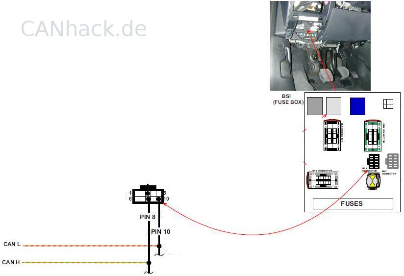

Beitrag30-03-2017, 10:29    Titel: Peugeot 207 CAN-Bus Zitieren
Paulius hat folgendes geschrieben:
adapter for what?
for reading CAN bus with PC: interfaces from Peak System.
For final applications: my own pcb.
Thanks, and where did you connect in the Peugeot cars?
OBD 6 & 14 pins with baudrate 500kbps I'm getting no data, but at least I did not get any errors on the instruments. Also tried 125kbps, but didn't help.
I connected on OBD 6 and 14 and like in my picture.
You can try this one as well:
 Peugeot 207 CAN-Bus
 Dateigröße:  36.37 KB
 Angeschaut:  988 mal

Beitrag10-04-2017, 16:14    Titel: Peugeot 207 CAN-Bus Zitieren
I got it working on ODB pins 6 and 14. I've got another question; does the wire thickness matter for an OBD connection? Can I safely use breadboard-type cable (0.2mm², AWG24)?
