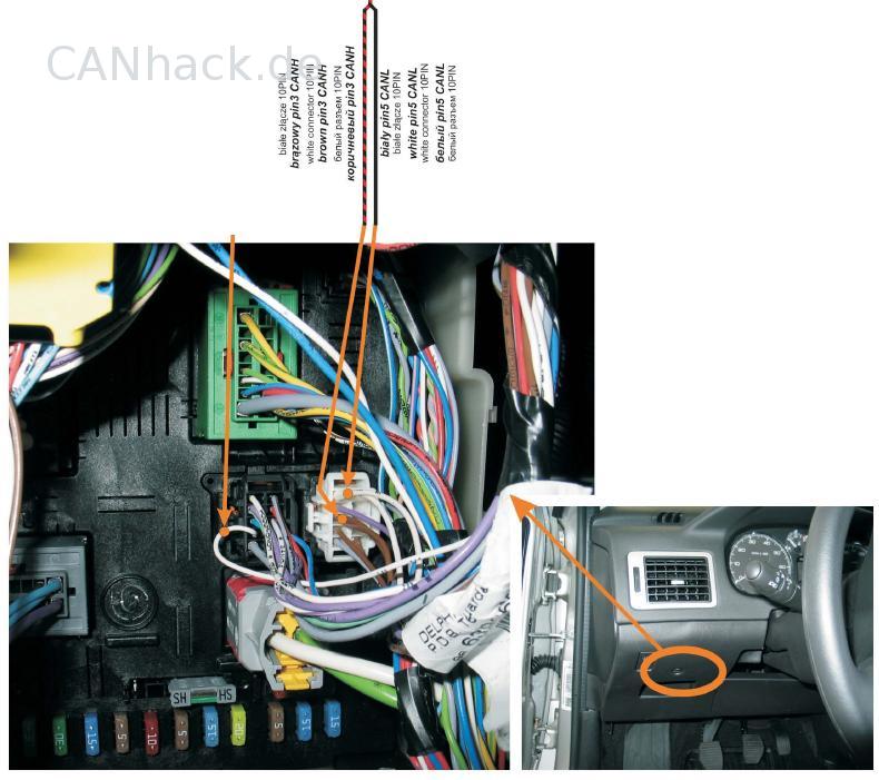

Thank you, and what data speed should I use?
When I try to connect, the whole system crashes (Multifunction display becomes blank, dials start to move, error lights are coming on).

Post27-03-2017, 17:20    Subject: Peugeot 207 CAN-Bus Translating...
baudrate i dont remember.. maybe 125kbps.
But you can try also OBD 6 & 14 pins. baudrate 500kbps.
With both connections you shouldn't get any errors on instrument cluster. Or your baudrate was not correct, or you switched high and low wires.
I connected my interface in Peugeot cars (308 was last one) and I did not get any errors.

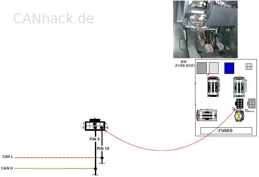

I connected on OBD 6 and 14 and like in my picture.
You can try this one as well:

Post10-04-2017, 16:14    Subject: Peugeot 207 CAN-Bus Translating...
I got it working on ODB pins 6 and 14. I've got another question; does the wire thickness matter for an OBD connection? Can I safely use breadboard-type cable (0.2mm², AWG24)?
