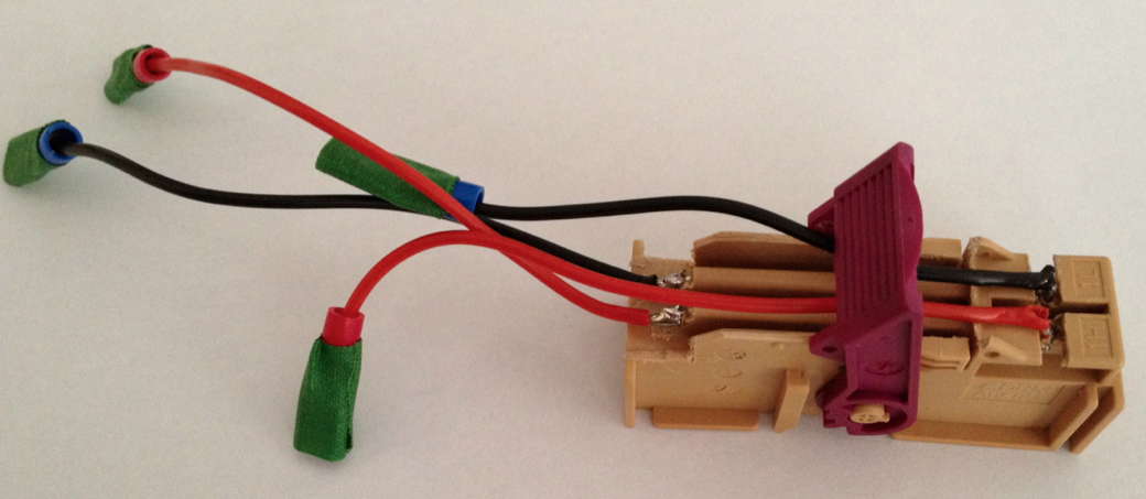

On an Audi, A5 model series, I've been digging around and identified the CAN gateway connector on the right side of the dashboard, which allows me to access CAN comfort, CAN combination instrument, and CAN infotainment (which is empty on these vehicles, as it uses MOST). At least that's something icon_smile.gif. I've also already identified some IDs, such as date/time, speed, seat adjustment, and VIN/FIN (CAN comfort). Next, I'll be moving on to the CAN combination instrument, let's see what else can be discovered there... I would be happy to "exchange" interesting IDs and experiences, especially related to this specific model series, with others.
Does anyone know if this connector (i.e., unmodified) is included in multiple Audi models besides the A5 series?
Attached is a picture of my modified CAN connector. This is a "replica" from Audi, costing a few euros, not the original icon_wink.gif.

I'm accessing the motor CAN bus, but I'm no longer sure if this is the one referred to as the CAN drive. He has a speed of 500 kbit/s, and he's overflowing with joy, which has made sniffing difficult for me on several occasions icon_smile.gif, meaning he's transmitting a lot of data.
The A5 has a CAN bus connector on the passenger side. You can buy a new one and drill it (I wouldn't want to do that with the original one). When sniffing network traffic, it's best to operate passively, meaning you shouldn't send any ACKs, even though it might not cause any real harm.

According to Elsa, there is no CAN drive present, but 500 kb/s seems to be the speed of the CAN drive.
Do you perhaps have a picture of your drilling site? Okay, so which pins do I need for that?

I have traces from all the buses. However, on the A5 (and possibly also the A4), the cameras should be located on the side of the bus (either the passenger side or the driver's side) and mounted on the dashboard (requiring the opening of a flap). What are you looking for?

We simply connect to the CAN cables and try to create the shortest possible connections. However, with 100 or 500k, that's not a major issue. The knot connector has been very useful.

You might be able to access the connectors directly, but often they are special plugs, and it's a tedious and fiddly process to disconnect them. I'm really happy with this CAN connector.
