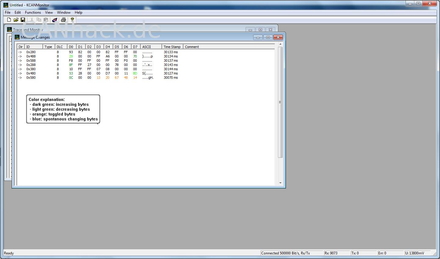

I suspect that the brake pressure data is not available on any of the car's CAN buses. However, if it *is* present, you can quickly identify it using the "Message Changes" view in KCANMonitor by observing what happens when you press the brake pedal.
The brake pedal switch should be located on the CAN drive unit.
Gear: Probably not, but possibly with an automatic transmission. Otherwise, the gear can be easily determined based on the relationship between speed and engine RPM.
 Die Bedeutung von Bytes in CAN-Nachrichten aufspüren mit KCANMonitor und der Message Changes Ansicht.
Wenn man das Bremspedal drückt, sieht man direkt welches Byte in welcher Nachricht sich wie ändert.
