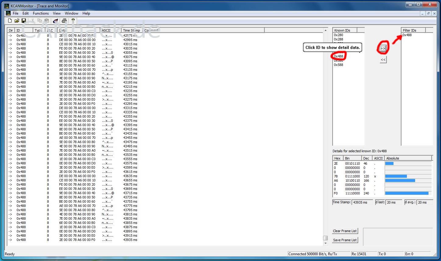

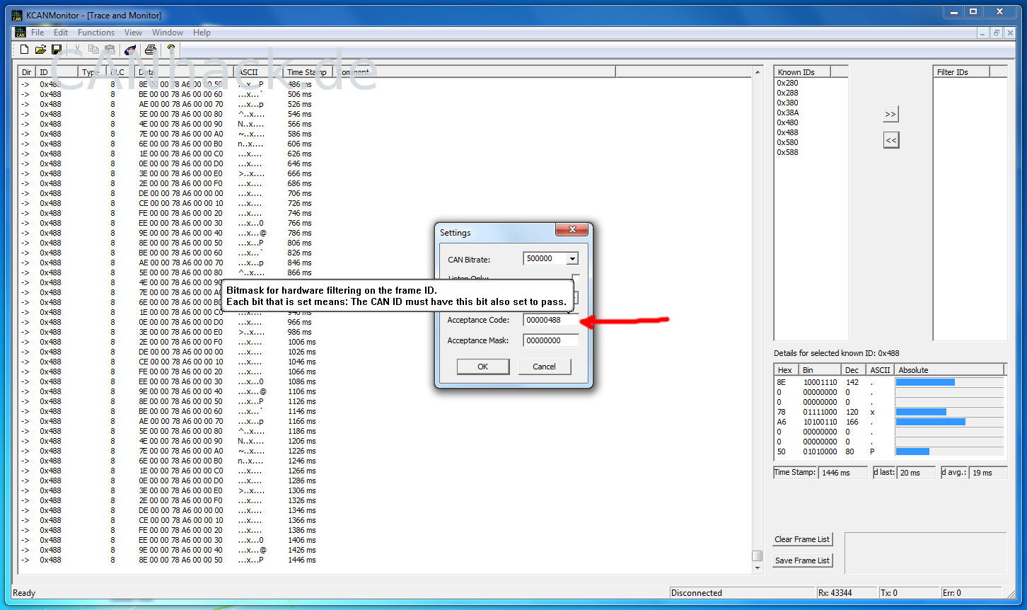

Need help configuring code/mask filters in can tool.
I only need ID 0x641.

Post21-04-2017, 12:37    Subject: Filter Help: Troubleshooting & Solutions Quote
With KCANMonitor, this is very easy. Since the hardware is powerful enough, you can usually use the software filters in KCANMonitor. Simply select the corresponding CAN IDs from the list in the top right corner and add them to the list of filtered CAN IDs using ">>".
Select the CAN ID to be removed from the list on the right and then click "<<".
If you have a slow computer, you can directly configure the CAN hardware filters in the RKS+CAN interface. This way, only CAN messages that match the filter in the interface will reach the computer.
When you hover your mouse cursor over the input fields, explanations will appear on how to set the filters.
For example, please refer to the images for CAN ID 0x488 in my case.
 Hardware CAN-Filter konfigurieren in KCANMonitor.

 Software CAN-Filter konfigurieren in KCANMonitor.
