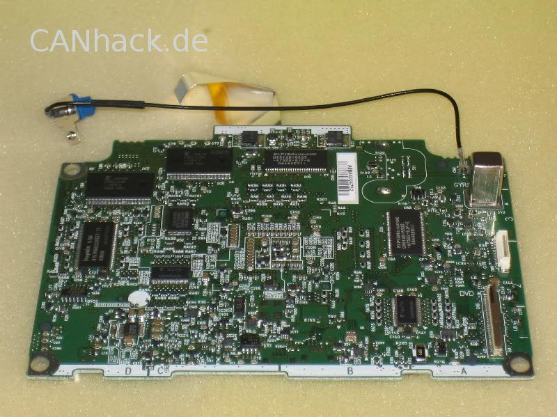

AudiA4B6US
Post29-08-2006, 23:50    Subject: TV Free for PC on RNS-E Quote
Tell me what the EEPROM might be, and I'll tell you what's written on it:

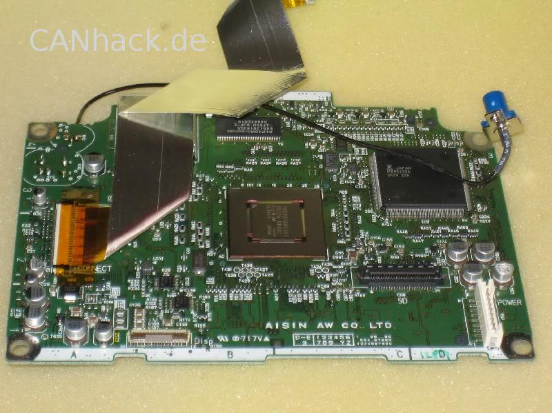

arthurik
Post30-08-2006, 9:55    Subject: TV Free for PC on RNS-E Quote
I sent you the link to the images via private message. I couldn't find a quick way to upload them here.
What I suspected, I have marked.
Translated on 12-07-2026, 3:39.
AudiA4B6US
Post01-09-2006, 22:24    Subject: TV Free for PC on RNS-E Quote
The chip on the top side, labeled C1, is marked as follows:
3793-7
0505
344
On the bottom sheet, in cell C4:
LVDS1
4 AM.
C9E7
The two connectors described in section B2 are 14-pin and labeled as follows:
VHC
T04A
507
and
VHC
T08A
505
Regards,
Dirk.
Translated on 12-07-2026, 3:40.
arthurik
Post03-09-2006, 22:04    Subject: TV Free for PC on RNS-E Quote
Okay, so none of the options mentioned are an EEPROM. But I've now opened up my navigation device. On the back of the device, there's a circuit board. The EEPROM chip, specifically the 9346, is located on that board. I'm going to try reading it out. I'll let you know if I find anything else.
Translated on 12-07-2026, 3:42.
arthurik
Post10-09-2006, 10:13    Subject: TV Free for PC on RNS-E Quote
Unfortunately, I haven't had any success while trying to read the data icon_sad.gif.
'First of all, I got my hopes up too soon. The designation '9346' unfortunately doesn't refer to the EEPROM '93c46'. I then disassembled my navigation system further and found the EEPROM '24c16'. Reading it hasn't worked flawlessly so far. I'm also not sure if there's anything useful on it, as I found the names of radio stations there.'
Translated on 12-07-2026, 3:43.
