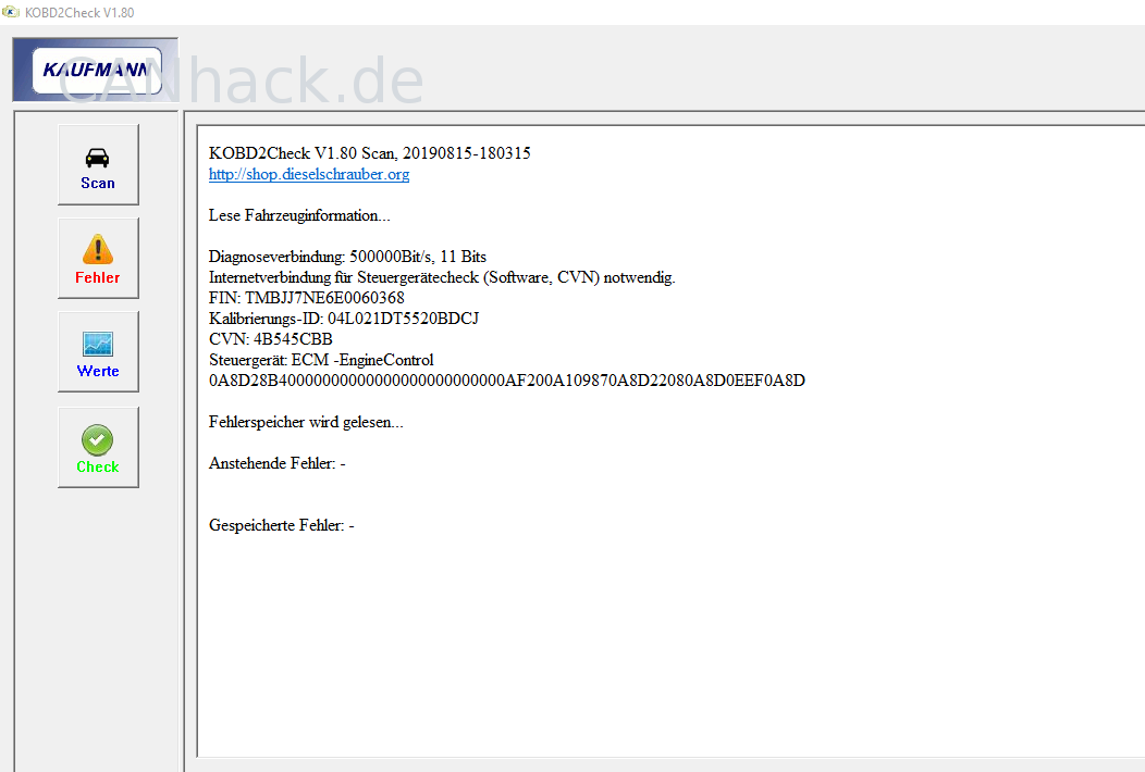

Post15-08-2019, 18:15    Subject: RKS+ CAN Interface: Troubleshooting & KOBD2Check Issues Quote
A few weeks ago, I worked on an Opel Combo from 2015 and a Ford Transit from 2009.
Of course, I didn't take any direct screenshots of either.
Today, I had a Skoda Octavia from 2016 on the diagnostic tool, and it had numerous error codes stored in its memory. I also took a screenshot of those error codes.
However, the tool did not display any error messages and also provided no information about the control units installed.
As proof of the existing errors in the vehicle, I performed an autoscan using VCDS. This scan displayed all the error codes. See attachment.
What do I expect from KOBD2Check?
It lists the control units.
It displays the entire error memory of the control units completely and correctly.
That I can clear the error memory.
At least, that's how KOBD2Check is advertised; I understand that it can be used to read data from vehicles other than those manufactured by the VAG group.
 Screenshot KOBD2Check
 File size:  45.22 KB

Post15-08-2019, 18:33    Subject: RKS+ CAN Interface: Troubleshooting & KOBD2Check Issues Quote
Hi.
As I suspected, the engine control unit from the Octavia 3 isn't included in your VCDS text-based scan.
Not because it's not possible, but because you were randomly changing settings within the VCDS program.
Please restore the default settings in the VCDS configuration.
KOBD2Check can read the error memory from the Octavia 3 engine control unit, and your KOBD2Check screenshot proves it. There are zero (no, - ) emissions-related errors stored in the engine control unit.
In principle, only the engine control unit can be read via }OBD2}, and the intended use of KOBD2Check and VCDS is usually different.

Post15-08-2019, 18:48    Subject: RKS+ CAN Interface: Troubleshooting & KOBD2Check Issues Quote
Hello Rainer,
I am aware that VCDS and KOBD2Check have different purposes.
VCDS is not configured in a "meaningless" way. It simply still had the checkmark enabled for using the K-line. icon_wink.gif
The description for KOBD2Check includes the following text:
Quote:
Features of this diesel mechanic OBD2 scan tool:
Read OBD2 control unit information (control unit part number / software version, VIN, CVN, etc.).
Read and clear OBD2 error codes.
Read and record sensor data via OBD2.
Check the control unit self-tests (readiness).
Since the text uses the plural form, I assumed that it can read out multiple control units accordingly.
